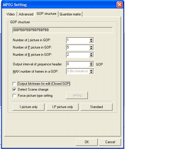

    Here's a SS of the GOP settings I had:
    I also tried it with the Max setting at 36, same problem, but again I am really new to this GOP thing.

    load the tmpgenc dvd (ntsc).mcf template and don't mess with the gop settings if you don't know what you are doing.
  3. Just do a closed GOP.

    The GOP limits are 15 frames for PAL and 18 for NTSC.

  11. You can't join the AVIs before you start? Then encode them separately and join in Muxman when authoring, both the video files and the audio files. Your pic shows an 18 frame GOP. That won't do. As guns1inger says, make it for 15 (and to allow for a margin of error, I'd use 12 frames). Some of these guys don't know what they're talking about. Open GOP is not only fine, but preferred. And you can't have an 18 frame GOP and then apply pulldown.

  15. When you say my pic shows an 18 frame GOP, how do you get that number?
    IBBPBBPBBPBBPBBPBB=18 frames
    1 I-Frame, 5 P-Frames, 12 B-Frames.
    While 18 frames is the max, once you apply pulldown the GOP size jumps because of the displayed framecount of 29.97fps.
    29.97/25=1.1988
    18 x 1.1988 = 21.5784.
    You'll have some GOPs as large as 22 frames. Following guns1inger's advice, and using TMPGEnc, you'd lower the P_picture count to 4. Personally, I'd use 3. It may not make any difference going from 25->29.97. It'll make a big difference applying standard 2:3 pulldown (i. e., you won't be able to use 4).

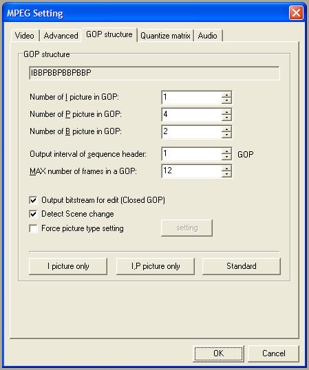

  20. Member FulciLives's Avatar
    May 2003
    Pittsburgh, PA in the USA
    Sorry I got here a bit late huh?
    To be safe you should change the GOP to 12 in TMPGEnc when following my guide. Perhaps that is something I need to add to that guide.
    So in effect you want to do this:
    This way you should avoid the GOP TOO LONG error message when following that guide of mine.
    - John "FulciLives" Coleman
    P.S.
    I just updated my guide to reflect this change.

    When I used TMPGEnc to encode it as ES, I did set the GOP P_Picture count to 3, as manono suggested, and that worked.
    As far as the DVD player goes. . . I've burned a number of DVD's in the past that have played on it, same brand as I'm using now and same burner. The authoring itself worked fine (using DVDAuther GUI), I got VOB files that I tested using my computers dvd-playing software. It was the actual dvd copy that I made that was messed up.
