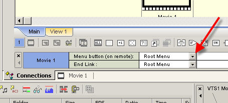

If you have DLP set up they way you want it to work, in the connections window the First Play should have an arrow going to your main menu. Title Button can point to that also. As far as using the remote to go back to the main menu, click on your movie then just below the connections window you should see menu button (on remote). Click on the drop down and navigate to where your main menu is.

That is how it is set up already, I burned a DVD as suggested but it's still exactly the same as described above
