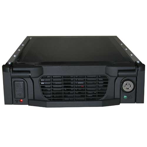

Hot swapping is in the SATA specification, so most any controller should work. If you are using a mobile rack with a removable tray for the drives, just get one with the electronic key switch that turns off the power and unlatches the tray before it can be removed. Make sure the internal and external power connectors match your drives and power supply cables and definitely get a unit with a internal fan.
