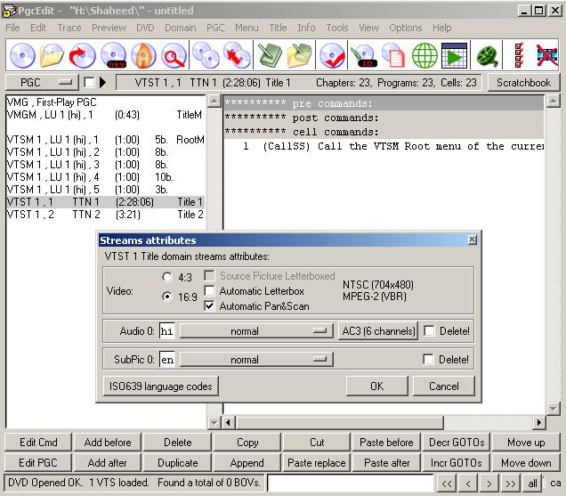

It's easy to do that in PGCEdit after you get done. As guns1inger says, it's not really Pan and Scan, but just a crop.
Right-Click the video, hit "Domain Streams Attributes", and change from 16:9->Automatic Letterbox to 16:9->Automatic Pan&Scan. Exit that screen and Save. -
