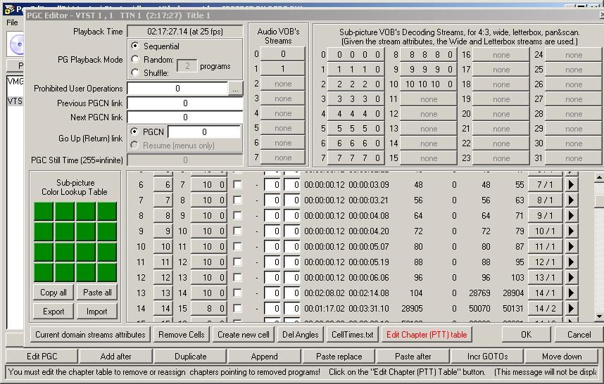

Hi,
I am trying to remove useless cells from a DVD with PGCEdit. I am doing this for the first time and would appreciate advice as I am not quite sure.
I opened the DVD in PGCEditor and after double clicking VTST 1.1..., I got PGC.
I checked the cells by clicking the small arrow against each cell. I could not preview the first 13 cells as the button "Play" cannot be clicked.
The button works starting with cell 14.1. When I click the arrow against the cell, the movie starts playing from the beginning.
Should I delete all first 13 cells? I am not sure whether it is OK to delete so many cells. Thanks.

vertical, you can definitely try the PGCEdit's way, but remember to process the result with FixVTS afterwards (because otherwise, the unused cells are not removed from the VOB).
Indeed, your PGC is protected, and there's a host of tiny cells before the actual movie, that's a definite pattern.
You can safely remove them. Then save the DVD, fire up FixVTS, process the VTS in question (drag and drop VTS_01_1.VOB for example), in-place (to save time), with the option "remove unreferenced cells" on. (all options on in fact).
This will leave you with a VOB file that starts with the movie (instead of the first crappy cells), and this might simply make it work.
It should take less than 5minutes to do the entire thing. If that fails, you could try bsj's suggestion (but I'm not sure why he's so sure this won't work, as it has for many many many people).
