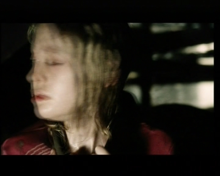

have read that the resulting mpg file will be pseudo-progressive i.e. with the blurriness on left to right movement.
Do you have any very short clips showing the problem that you can upload for us to have a look? -

Not sure how to get an mpg file on here (2mb isn't enough) but I have included a picture that should illustrate the problem. I gets worse the faster the movement.

From what I have read this device starts with interlace, passes through WIS chip and the output file has the fields blended, given the result in the picture.
I found this reference and located the file it is in:
//deinterlace_mode = 1 // 0: use one field, 1: deinterlace, 2: interlace coding
but changing the options doesn't appear to do anything (at least not to me).

That is a blend deinterlace.

I had seen it called blend deinterlace but also psuedo-progressive.

You might have to reboot before the changes take place. Try setting 2. After rebooting capture some video. Then use VirtualDubMod to view the resulting files. You should see interlace comb artifacts. Some media players will deinterlace while they play so you can't trust what you see with them.Originally Posted by lwaves
Thanks jagabo.
But I had already tried that. Its default was option 1. I changed it to 2 and restarted but no difference. For the hell of it I even tried option 0!!!
