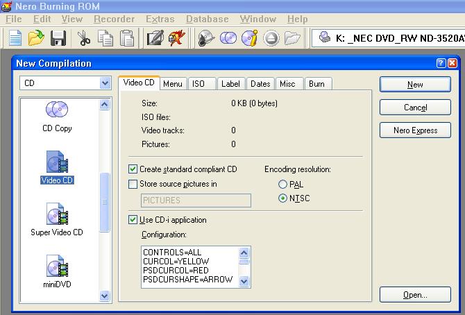

    Thats weird because it always says if its over that there might be a problem with burning it and where do i go using nero startsmart to use the vcd template?Cause i no how to get into the vcd menu and adding it using nero but i dont understand wut ur talking about about the vcd template thing inside nero any screenshots would be appreciated.
    Gods disaster is a brilliant mistake of the things that are one hit wonders!
  6. Note that VCD uses mode 2. Mode 2 has less error correction than mode 1. This frees up additional space. A 700MB (mode 1) CD can hold over 800 MB in mode 2.

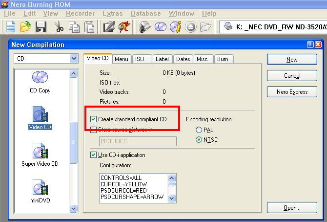

    In Nero Burning ROM: File -> New:

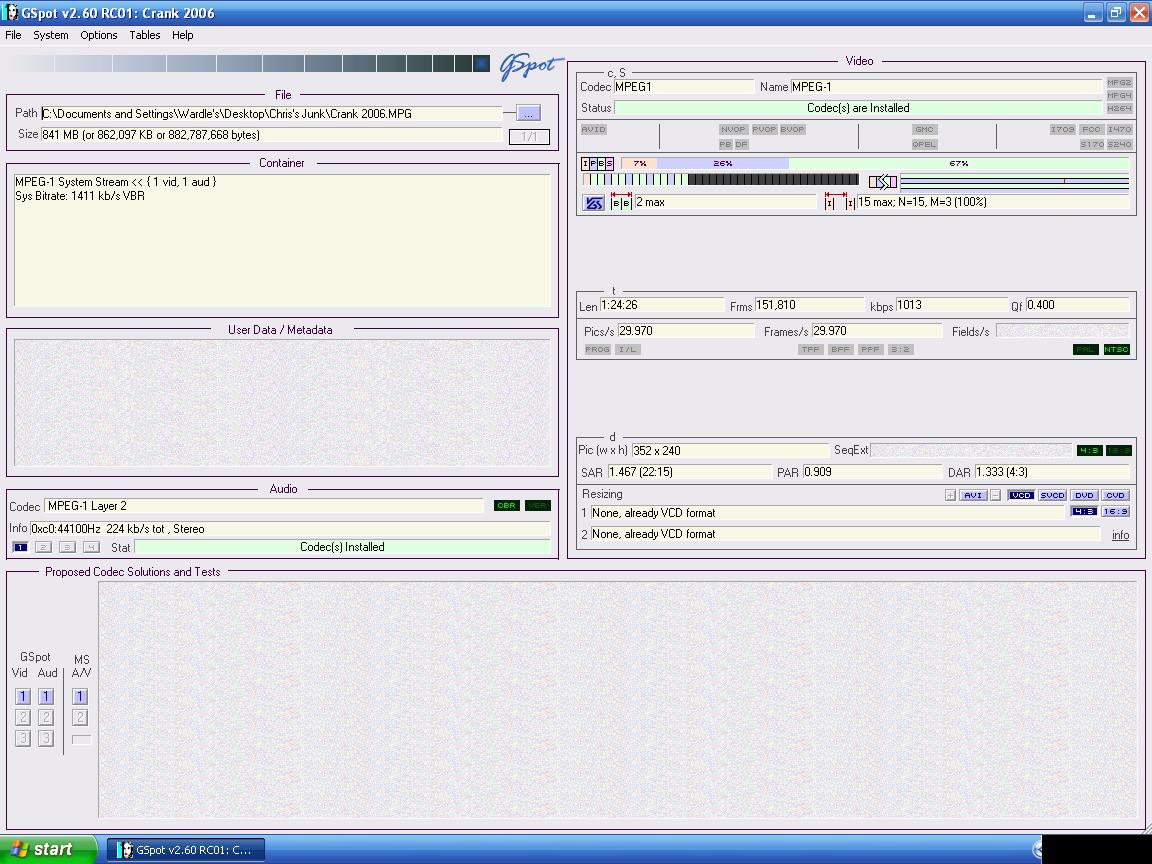

  8. You don't have to specify mode 1 or mode 2, Nero does it automatically. Are you sure your source file is VCD compliant? Maybe it's PAL not NTSC? What does Gspot say about the MPG file?
    Jan 2007
    First off this aint Crank as in a drug movie its Crank with Jason Straham with Amy Smart now secondly i sent ya a screenshot of what i came up with inside of GSPOT so any suggestions now that u can see what kind of compliant it is..please help figure out my problem within the MPG peace!
  10. The running time of your video is a bit long (84 minutes) and the bitrate is a bit low. I think this may be what Nero is complaining about. Your file is not 100 percent VCD compliant, it's an XVCD. I think Nero will complain about that, but if you ignore the warning it will go ahead and burn a VCD. Try turning off the "Create Standard Compliant CD" setting:
