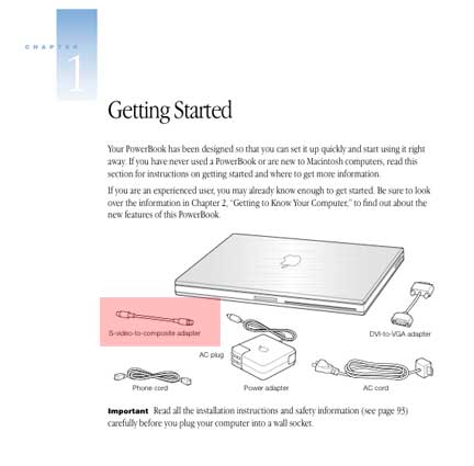

2. To Hook up your VCR or TV to your PB, use the Composite adapter to S Video cable that should be included with your PB. ( side note it looks like this.
or this
Hookup a standard RCA video cable to it,
and then hook that cable up into your vcr or tv or device that accepts RCA inputs.

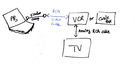

so in short, with that cable, you should be able to display mirroring of
SVideo output to RCA input on to a TV or VCR that has composite(RCA) input,
which then in turn displays video through Video1, Video2, or Channel 3 for input
of external device.
so I also included a quick diagram to show how it should all look,
this of course depends upon your setup being able to accept something like this:
