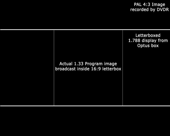

At a guess, you recorded this from a digital settop box. It looks like a 4:3 program, broadcast on Australian digital (16:9), but recorded in letterbox mode. To get it to fill the screen you need to have the settop box set to fullscreen or 4:3 or whatever it calls it. I know my PVR can display this to fill the screen, but if I have the box set to 16:9 it would record as very tall, and in letterbox mode, just like you have here.

A lot of DVD Recorders don't seem to record 16:9 correctly, and in fact only record it as letterbox instead.However you have all your equipment set up, what you have recorded is a 4:3 aspect ratio image, with a 1.788 (16:9) letterboxed broadcast of a 1.33 aspect ratio program
The only way you can get it recorded fullscreen is if the Optus cable box can output a full screen image, instead of a letterboxed widescreen image.Read my blog here.
