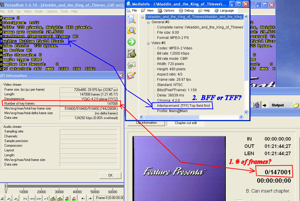

Question #1. I get two different framecounts from VirtualDub w/avs script (147008) and TMPGEnc DVD Author w/raw mpeg2 capture file (147002). Why and which is correct?Originally Posted by AVISynth Info Script
Question #2. I get two different field order parity in VirtualDub w/avs script (BFF) versus MediaInfo (TFF). Why & which is correct?

1. VDub
2. VDub
I don't know how you'd confirm the frame count short of counting all the frames yourself. Maybe there are some undecodable frames at the beginning that VDub counts and TMPGEnc doesn't. Anyway, you're a bit out of date with that script. You should be using DGDecode.dll and MPEG2Source after making a D2V using DGIndex:
http://www.neuron2.net/dgmpgdec/QuickStart.html
Also, Aladdin is a movie, I guess, and should be IVTC'd back to 23.976fps
It's an easy matter to confirm the field order. Add this to the script, open in VDub, find a place in the video with motion/movement, and advance a frame at a time:
AssumeBFF()
SeparateFields()
If it plays smoothly, it's BFF. If it plays jerky/stuttery, it's TFF. Now make it:
AssumeTFF()
SeparateFields()
Should be the opposite of what you found before. If it plays jerky, it's really BFF. -
I agree with manono that the old MPEGDecoder.dll is prone to problems. That is likely the source of the frame count problem.
I have a Hauppauge WinTV PVR-250 and it always records top field first. -

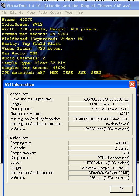

@manono & jagaboThanks for putting me onto DGIndex & MPEG2Source. I ran DGIndex on the CAP video file and updated my AVISynth script.
As you can see, VirtualDub now shows a framecount of 147013 & field parity of TFF. I assume this is the correct framecount & field order. Thanks again.Originally Posted by Updated AVISynth Info Script

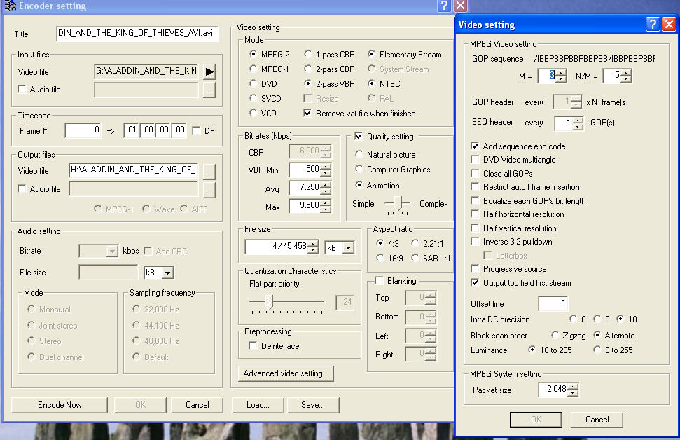

7. For two CCE-basic & the one TMPGEnc-Plus I use AVS to frameserve to the encoders. For the forth encode, which used CCE-basic, I open the AVS script in VirtualDub and save that to an AVI file using Panasonic DV codec. I then encoded that AVI. The figure below shows the CCE-basic settings for that encode.
8. As you might anticipate my question is why are all these encodes coming out 480 MB undersized? What am I missing? It's got to be something simple.
My guess is that you've "saturated the codec". Run your MPV or M2V through BitRate Viewer and check the Q-Level. I think it'll probably be below 2. That's a very high bitrate you're giving it. You've given it all the quality it can get. Plus you've made it more compressible by smoothing the hell out of it.
If you want to boost the size, either lay off the denoising/smoothing, or use a much better quantisation matrix, or both.
And as I said in my first post, you should probably IVTC the thing, instead of keeping it interlaced (which you're going about the wrong way, but that's a subject for another thread). -
@manono, thanks for your help.
Q level, average = 2.05 & peak = 7.34. Bitrate, average = 5838 & peak = 8859. Is saturating the codec good or bad? Is it telling me that what I'm getting is the highest quality that I can get? If I lay off the denosining/smoothing, wouldn't that degrade qaulity?Originally Posted by manono
