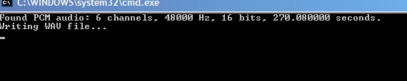

I use AC3GAINv4 to increase AC3 volume.Everything is all right but in result I get mono file instead stereo.Please help me.
1)Can you check your original AC3 file to see if maybe it is mono?
2) For a test, run AC3gain on the Output file again. Look at what the batch file says.
First Run on Original File - 6 channels (5.1)
Running Ac3Gain again on the normalized output file - 6 Channels again
Soopafresh, if we have AVI files with arbitrary audio encoding, would you pls be so kind as to confirm if this (adapted from an older one of yours) provides a similar outcome in terms of gaining and DRCing. Drag'n'drop an AVI on the .bat file or call it from another .bat like
The 1st ffmpeg line is supposed to extract from the AVI anything ffmpeg understands into PCM for avisynth to do it's thing.Code:CALL "C:\SOFTWARE\AFTEN\do-AFTEN-new.bat" "G:\path\input_file.AVI" "G:\path\outputfile.AC3" 224 1.5
EDIT: just saw a reference to AC3normaliser above. Will have to read up on it now.Code:@echo off REM https://forum.videohelp.com/topic317891-30.html#1853429 REM https://forum.videohelp.com/topic314909-60.html#1823321 REM http://www.hometheaterhifi.com/volume_7_2/feature-article-dialog-normalization-6-2000.html REM REM Output = .AC3 normalised and DRC'd - wgvalues in range 1.2 (less) to 2.5 (more) REM Number of channels stays the same (I think) eg 2 or 5.1 channel input remains unchanged REM 1st parameter is the input .AVI file REM 2nd parameter is the output .AC3 file (default inputAVIfile with .AC3 extension) REM 3rd parameter is the bitrate, eg 192 (default 192) *** NOTE no "k" on the end REM 4th parameter is the DRC value from 1.2 to 2.5 (default 1.5) REM SET inp=%~1% SET outA=%~1%.AC3 SET outW0=%~1%.TEMP0.AC3.WAV SET outW1=%~1%.TEMP1.AC3.WAV SET avs="%~1%.TEMP.AC3.AVS SET normvalue=0.95 SET drcvalue=1.5 SET dialognormvalue=31 SET bitratevalue=192 SET freqvalue=48000 IF NOT "%~2"=="" SET outA=%~2% IF NOT "%~2"=="" SET outW0=%~2%.TEMP0.AC3.WAV IF NOT "%~2"=="" SET outW1=%~2%.TEMP1.AC3.WAV IF NOT "%~2"=="" SET avs=%~2%.TEMP.AC3.AVS IF NOT "%3"=="" SET bitratevalue=%3% IF NOT "%4"=="" SET drcvalue=%4% "c:\software\ffmpeg\ffmpeg.exe" -y -i "%inp%" -vn -acodec pcm_f32le -f wav "%outW0%" @echo SetMemoryMax(128) > "%avs%" @echo LoadPlugin("C:\SOFTWARE\aften\AudioLimiter.dll") >> "%avs%" @echo #LoadPlugin("C:\SOFTWARE\aften\soxfilter.dll") >> "%avs%" @echo #WavSource("%inp%").ConvertAudioToFloat().SSRC(%freqvalue%).normalize(%normvalue%) # all AviSynth filters >> "%avs%" @echo WavSource("%outW0%") >> "%avs%" @echo #AVISource("%inp%") >> "%avs%" @echo ConvertAudioToFloat() >> "%avs%" @echo SSRC(%freqvalue%) >> "%avs%" @echo normalize(%normvalue%) >> "%avs%" @echo # WavGainLimiter - >> "%avs%" @echo # to increase volume for silent sounds a lot, >> "%avs%" @echo # to increase volume for middle-volume sounds a little and >> "%avs%" @echo # to keep hi-volume sounds untouched. >> "%avs%" @echo # This must help to increase volume for speech/dialog without increasing volume for shoots etc >> "%avs%" @echo # Higher factor values increases the effect but can produce atrifacts. >> "%avs%" @echo # Recomended value between 1.0 and 5.0 >> "%avs%" @echo # This filter requires Normalized Float audio at input. >> "%avs%" IF NOT "%drcvalue%"=="" @echo WavGainLimiter(%drcvalue%) >> "%avs%" "C:\SOFTWARE\aften\wavi.exe" "%avs%" "%outW1%" "C:\SOFTWARE\aften\aften.exe" -v 1 -dnorm %dialognormvalue% -b %bitratevalue% -readtoeof 1 "%outW1%" "%outA%" REM A truly Excellent article on Dynamic Range Control and Dialog Normalization, with diagrams ... REM http://www.hometheaterhifi.com/volume_7_2/feature-article-dialog-normalization-6-2000.html REM When we speak of how loud sounds are in a Dolby Digital soundtrack, REM we express the loudest level as "0 dB" and the quietest as "-105 dB". REM The Dialnorm value expresses the level of dialogue as how much lower REM it is then the peak (0 dB). REM So a value of "-31" indicates a point 31 dB below the peak and, incidentally, REM is the value at which no volume adjustment is performed by your consumer decoder. REM A Dialnorm value of -27 would indicate to your decoder that the dialogue is REM at a point 27dB below the peak, or 4dB higher than a program with a Dialnorm value of -31. REM Your decoder would then turn things down by 4 dB. REM A Dialnorm value of -25 would call for a 6 dB reduction and so on. REM The -27 setting "fits" movie soundtracks perfectly in that it yields a very natural level REM for talking and is likely the most common for movies. REM For decades this has been the standard level for dialogue in motion picture soundtracks. REM pause
The AC3 original file sounds stereo I ripped it from DVD but when I use Ac3gainOriginally Posted by Soopafresh
on the first run the batch file says Could not find C:\ac3gainv4\.avs
Found PCM audio; 6 channels, 48000 Hz, 16 bits and it still do its job but result is mono.

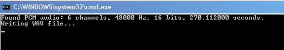

On the second run with the normalized file it says Found PCM audio; 6 channels, 48000 Hz,
16 bits and it still do its job but result is mono anyway. -
