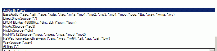

Is there a way to use AC3 2.0 files, or can it only be done with 5.1?Also when using 2.0 ac3 files you loose the right channel upon conversion. -

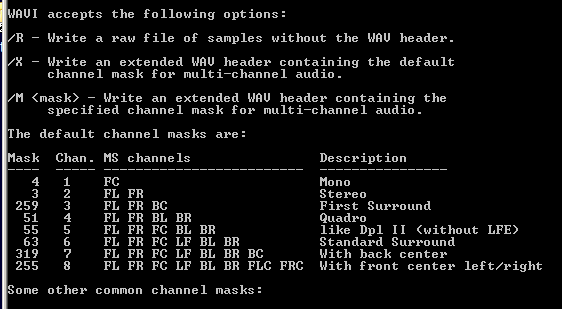

The AVS script doesn't show a mask for WAVI.EXE
May need to ask for number of channels as you do with compression & bitrate OR better yet find out how many channels and automatically set the mask.
Or am I barking up the wrong Eucalyptus.

Yeah, I didn't really consider the issue with Wavi. Wavi is a fairly recent replacement for Bepipe.exe , a similar app which requires .NET 1.1 or later to be installed. I don't know if Bepipe would automatically send the same number of channels that the source AC3 contains.
Here's the same batch file structure, using Bepipe in place of Wavi. Would you guys mind testing it out? I don't have any AC3 files on the machine I'm currently at.

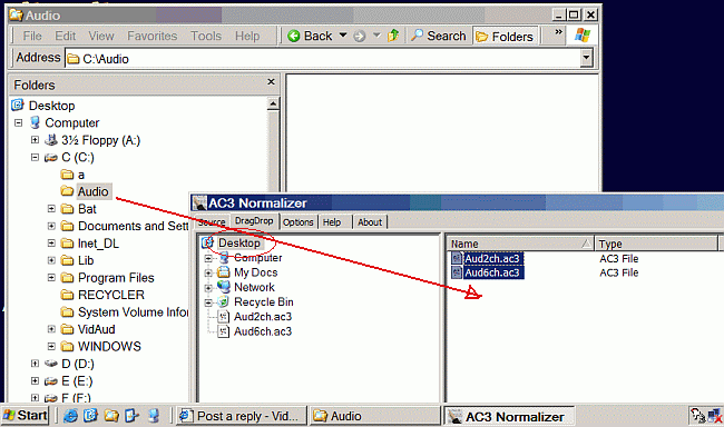

I've been dragging AC3 files, using Windows Explorer, to the Drag & Drop pane.
AC3Normalizer is in the 'c:\a' folder
I dragged and dropped 2 files from the 'C:\Audio' folder.
The Drag & Drop process deletes the files from the 'C:\Audio' folder and places them on my Desktop
I'm not sure what's happening. I'm positive the files end up on the Desktop.
Hope this makes sense.
You are right, it shouldn't happen. It didn't happen when I was bug testing it. It also seems that the AC3 files on the desktop are not transcoded either.
Thank you, I'll look into this and upload an update as soon as it is fixed
Ok, the bug has been squashed lol (I hope) and updated files uploaded.

Drag & Drop now moves the files to the same folder as AC3Normalizer. Needs to not move or copy but work with them in situ.

Re DragDrop, it is supposed to move the file(s) to AC3 Normalizer folder. There may be other AC3 files in the original folder which don't need processing, and if I drop from outside the app it has no idea where the file came from. For processing in situ, use the Source option and browse to the folder inside the app, not Windows Explorer.

Gotcha with the drag & drop. -
