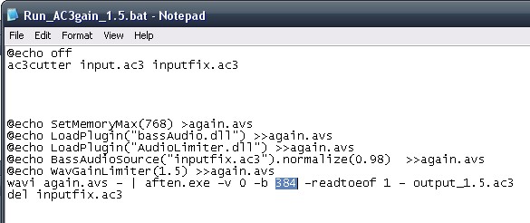

what is the use of avisynth. says it is requried. but nowhere in your post reference comes about avisynth. only ac3 gian is the subject of discussion here. plz explain why we neeed avisynth?
It works like this:
AC3 File ----->Avisynth---->Encoder
This happens automatically in the script. You must have Avisynth installed, plus .NET 1.1 or later for it to work
i downloaded Ac3gain v3..Unzipped it.As per your instruction --drag your ac3 file into ac3gain batch......but i found four RUNac3gainfiles in the unzipped folder.---viz 1.5,1.8.20,2.5. to which one should i put the ac3 file. i tried with the sample input ac3. 819 kb and clicked the Runac3 gain 2.0.. then i got a ac3 2.0 output file which is only 2.0 kb! am i right? how can i check the sound quality?Run ac3gain 1.5, Run ac3 1.8....what are these?
Make sure your AC3 file is named INPUT.AC3
1.5,1.8.20,2.5 is the amount of volume, with 2.5 being the loudest.

Is there anyway to make the output file's bitrate 448K instead of 384K?
I have been working with ac3gain for a few months now. I have to say it is a very good software for movie. But if you use it to change the volume of music, you may have problems like I do. First, you have to go by the preset volume. If you want the to increase the volume to somewhere in between you are out of luck. another problem is it does change the equalization of the music. I wonder if there is a software that just change the volume w/o changing the equalization for ac3 music file. In other words, it just turns up or down the volume and retains the original equalization.
It's probably the WAVgainLimiter line in the batch file. Try deleting that line for music (I think)

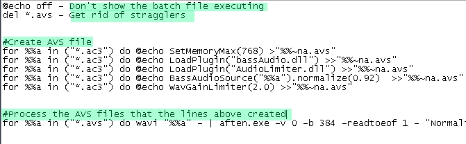

Go right ahead. Very little of the thing is mine, per se. All I wrote was the batch files to execute to process.
When you create a program from other free or opensource apps, you need to either include the source files in their unchanged form, or link to the Urls of the people who authored the code. That's why I created a folder called source. Other than that, none of the files in that folder are accessed during the batch file execution.
This line is not in my batch file (the one I downloaded from your link ac3gain_experimental_music_version.zip)
Thanks for explanation, will give it a go.Code:for %%a in ("*.ac3") do @echo WavGainLimiter(2.0) >> "%%~na.avs" -
wavgainlimiter is a plugin which adds dynamic range compression to the audio, so the loud parts and the quiet parts of the movie are closer to each other in volume. It makes a sound difference. Try out the batch files for yourself.
