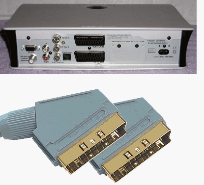

    I attached a pic of back of my reciver and be happy if what connections from back my reciver can be utilized. Furthermore, what should tell the sales man so he give me the reight card ?Thanks

    Well if you hadn't already mentioned it I would let the sales person know EXACTLY what type of service you have. Be specific - if its analog or digital cable or satellite.
    You can essentially record to and from any device as long as it has the old rca video cables (you know the ones color coded yellow for video, white for left audio and red for right audio). Just hook the output from your source to the input on your capture card and you are set to go - very basic and usually foolproof as long as the source isn't corrupted.

    Yes if you have the rca out just plug them into the recording device assuming it has a rca in jack.
    It does it from digital to analog in the satellite/cable box first - that device sends out the anlog signal thru the rca cables. Your capture device will just then process them as if they came from an old vcr.
