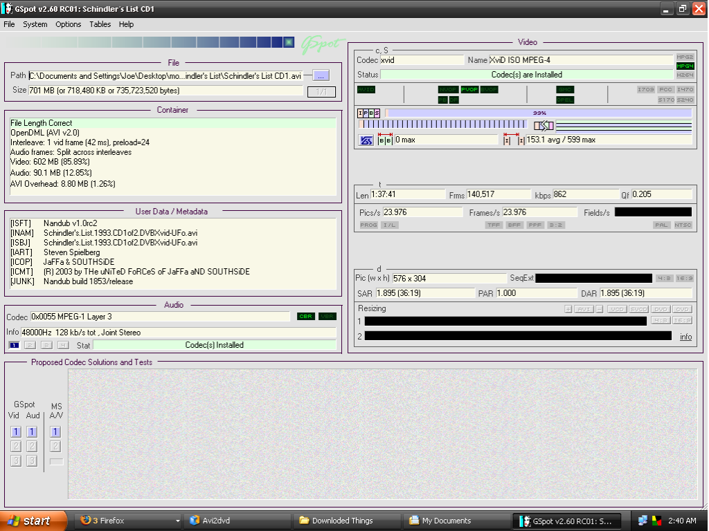

    1. Some details about the avi file in question - perhaps a screenshot from g-spot 2.60beta. (You can hide any incriminating file names before posting, if you want to)
    2. Some details about the actual settings you have used in avi2dvd, including which encoder, at which point, exactly, does the program go belly-up ?
    That it happens in different movies would suggest that there may be problems with codecs, or with avi2dvd. Perhaps screenshots from several avis would help find a common link.
