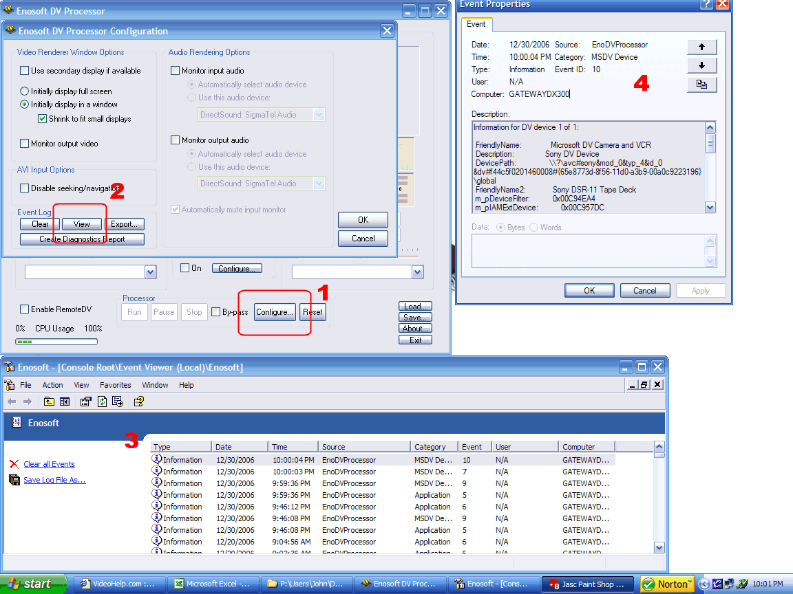

 Our Enosoft DV Processor gathers information about attached DV devices and records that information to the operating system's event log. The information may help determine what's going on.
 The attached screenshot shows what to do....
 Connect the DVD recorder such that Windows recognizes it
 Launch the software and click the large Configure... button (1)
 Click the View button in the Event Log group (2)
 This should display a window similar to (3)
 Look for an entry that has MSDV Device in the Category column and double-click on it
 This will open the entry in another window (4)
 You can copy-and-paste the information in the scrollable text area

	I’ve installed the no-license version of Enosoft and it successfully allows me to feed a DV stream from by computer into Philips DVDR615 DVD Recorder through its firewire connection and record to DVD. Windows and Enosoft recognize the DVD recorder as “AVC compliant DV camcorder.”
 I tried it two ways, which both work. 1. Feeding a DV avi file (one that was previously captured) and 2. Sending a VHS signal through my Sony DigiCam into my computer and then out (via another firewire connection) into the DVD Recorder. This second method allows me to fix the IRE issue with Enosoft’s video processor, and encode the capture in real time with the DVD recorder, getting the benefit of the signal processing of both the Sony and the DVD recorder.
 Enosoft’s controls (record etc.) do not work for the DVD recorder, but that is no problem, since I can use the controls on the DVD recorder to start and stop recording. The main thing is that the DVD recorder accepts the DV input, something that no other program ever allowed me to do. Very impressive!
