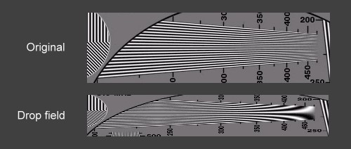

While searching the forum on converting 1080i to DVD, I've noticed that some people do some crazy insane AVISynth scripts to resize and keep the video interlaced. No offense, but I'm just wondering why do people do this.
For me at least, when I convert to DVD, I usually set my encoder to ignore one field and then have it resize the other field to 480, which I then author as a 480p DVD. That way, I'm going from 540 lines (one 1080 interlaced field) and then dropping the resolution to 480 progressive lines.
Since one 1080i field still has more lines than one progressive DVD frame, shouldn't my method be fine?

Hi-
If the 1080i source is truly interlaced (shot on video), by tossing out half the fields, you've cut the motion fluidity in half. If the 1080i source is from a movie (shot on film), by tossing out half the fields, rather than doing a full IVTC, you've made a video where every 5th frame is a duplicate frame, making it play jerky. To answer your question, your method most certainly is not fine. -
wow that is a bad way to do that..... if anything deinterlace it then resize it, droping a feild is just bad to do.
