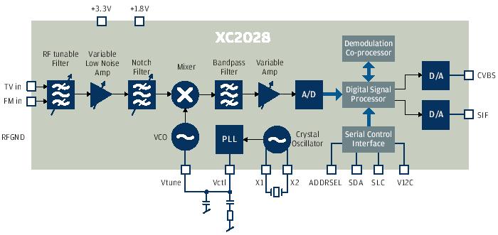

  7. It mostly just needs a good stereo tuner. You ever look into modifying those kinds of components?
    Stereo tuner is a bit of a misnomer. Here is an example of what what a tuner does.
    Notice in the lower left, the output labelled SIF. That means Sound Intermediate Frequency. That signal has stereo information if it is broadcast that way, but what the recorder designer does with it is what determines if the recorder can only present mono sound from the tuner. In the RCA it means that it is parts on the main board with the mpeg processor that determine if it will have mono sound. I do not want to redesign their main board with the mpeg processor but it would require that.

  16. Originally Posted by trhouse
    The Xc2028 should have a stereo output mode, since it has dual D/A.
    Note : This Devices does not recover the stereo pilot tone from the RF signal, so it is not suitable for mobile application, like automobile.
