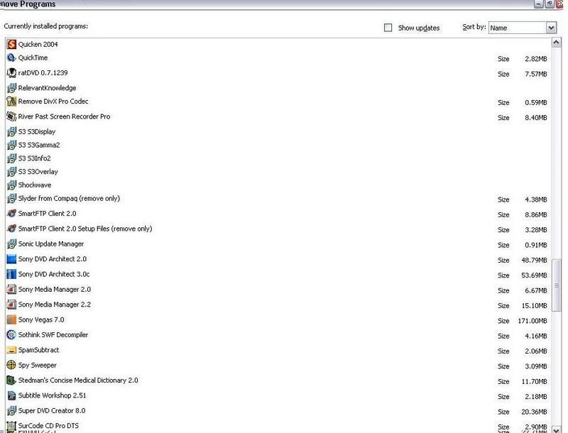

  1. my windows keeps restarting on me for no reason. i think i installed something that is making my pc start. i tryed to restore my pc but it wont restore. this started when i connected my video camera to my pc and i think i installed something for the USB, but im not shore.
    heres a pic of the restore and all my programs and the error, maybe you guys can see what i installed that made this problem

    You have a lot of programs loaded. That makes it hard to tell if there are some conflicts. But maybe the MS report will give you some ideas.

    first you should clean your computer. you are still having malware problems. after windows loads properly, you should then reinstall any software that isn't functioning properly.
    me personally, after that i'd uninstall a good 50 programs from that list and defrag the hard drive...
