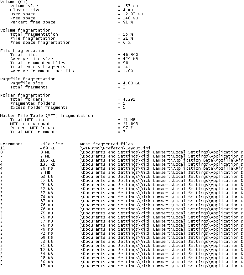

  13. Member golfnut's Avatar
    Sep 2003
    oldandinthe way thank you for the info. How do I map the drive? I saved the defrag analysis to a file in my documents but can't get a screen shot to work here. Unfortunately I am not a computer guru. Would you like for me to email the file to you? I at least think I can do that if you could send me your email address. Thank you.

  14. Member golfnut's Avatar
    Sep 2003
    Lets try the screenshot one more time. See below, maybe it will work this time.

  19. Member oldandinthe way's Avatar
    Mar 2006
    With the other crabapples
    I don't understand why you have 31% file fragmentation on a 91% free space disk. What is the application which is generating all of those local settings files? (The screen shot cuts off the info at the right.)

  22. Member golfnut's Avatar
    Sep 2003
    oldandintheway here is a new screen shot, hopefully better. Looks like most of the applications are created by mozilla firefox.
