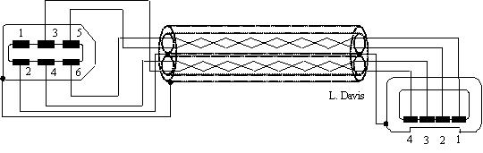

    6-pin on the left, 4-pin on the right. The difference is the 6-pin carries power for powering smaller devices. Note the one on the right in Jim's pic is very similar to the smaller USB connection. Here's another pic:
    Commonly you'll find the 6-pin on a computer and the 4-pin on a cam. Therefore you would need a 6-pin to 4-pin cable.
