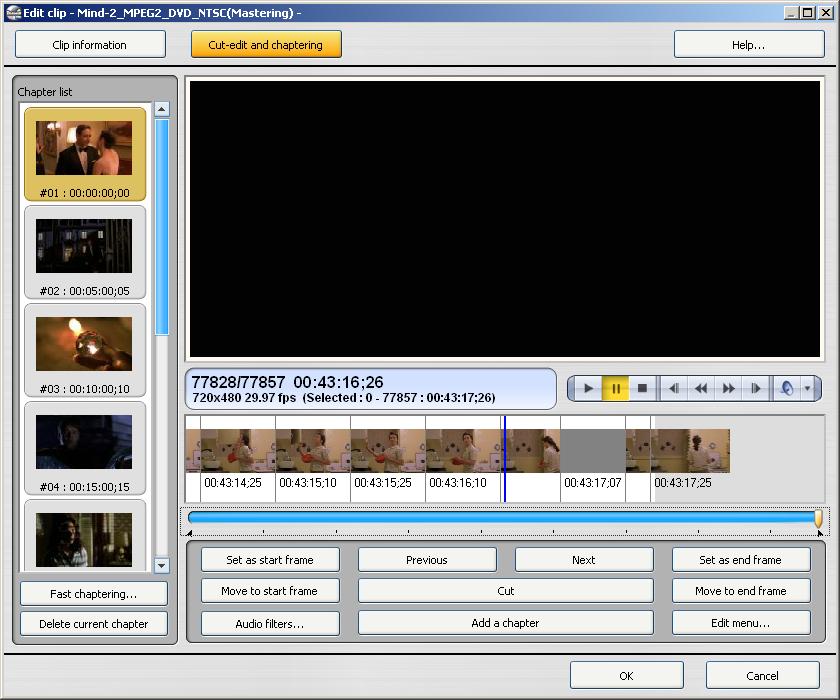

Hello everybody,
I am trying to author a DVD with TDA. It consists of three m2v files plus three ac.3 files.
I need to remove the "extra chapter points" otherwise the DVD does not run smoothly on my stnadalone. It makes a pause between sections 2 and 3.
If I understood the advice with regard to the "extra chapter points" right, such a chapter point is the very first chapter of the section 2 and the very first chapter of the section 3. The first chapetr of the section 2 can be seen on the pic: left top chapter (yellow frame) on the left-side vertical bar "Chapter List".
I tried to remove it but the DVD still have a pause betwee the sections. I believe I do not undersatand what "the chapter point" is though I read the manual.
Please also advise about the grey frame that you can see among the thumbnails. I tried to cut it off but after that I have a frame (the closest one to the one that was cut off) repeated without audio on the screen when playing back the DVD.
Thank you!
The grey frame you see may come from dismatching of audio/video either in the end of previous video (e.g. audio is longer than video but you can't hear it if it has silence in the end) or in the beginning of the next one added to the track. You can try to cut out this range after all videos are added to timeline (the best way to do it is using TMPGEnc MPEG Editor before authoring, TDA cuts not as clean) and preview the result.
The chapter point selected in your picture is the beginning of timeline (00.00.00) and can't be deleted. -

Hi,
I am sorry to bug the community with the same problem.
Before posting this, I did my home work and read the manual again but I do not understand the part refering to the chapter points. What I understood from the manual is that a "chapter point" is actually a chapter.
I do not get what chapter point/chapter I must remove to make playback smooth. I've posted the picture hoping that somebody would be kind enough to explain the issue based on the picture.
I really appreciate the time you, guys, spend helping me but if you read the replies to my question in the post closely, you would see that no reply advises specifically what chapter point/ chapter I need to remove.
I believe I am the reason of this because I posted question as "How to remove...." while I do not understand properly what to remove.
I stuck with the DVD. If somebody would be kind enough to explain it in a way that is OK for a newbie, I would be really thankful.
Thanks!
