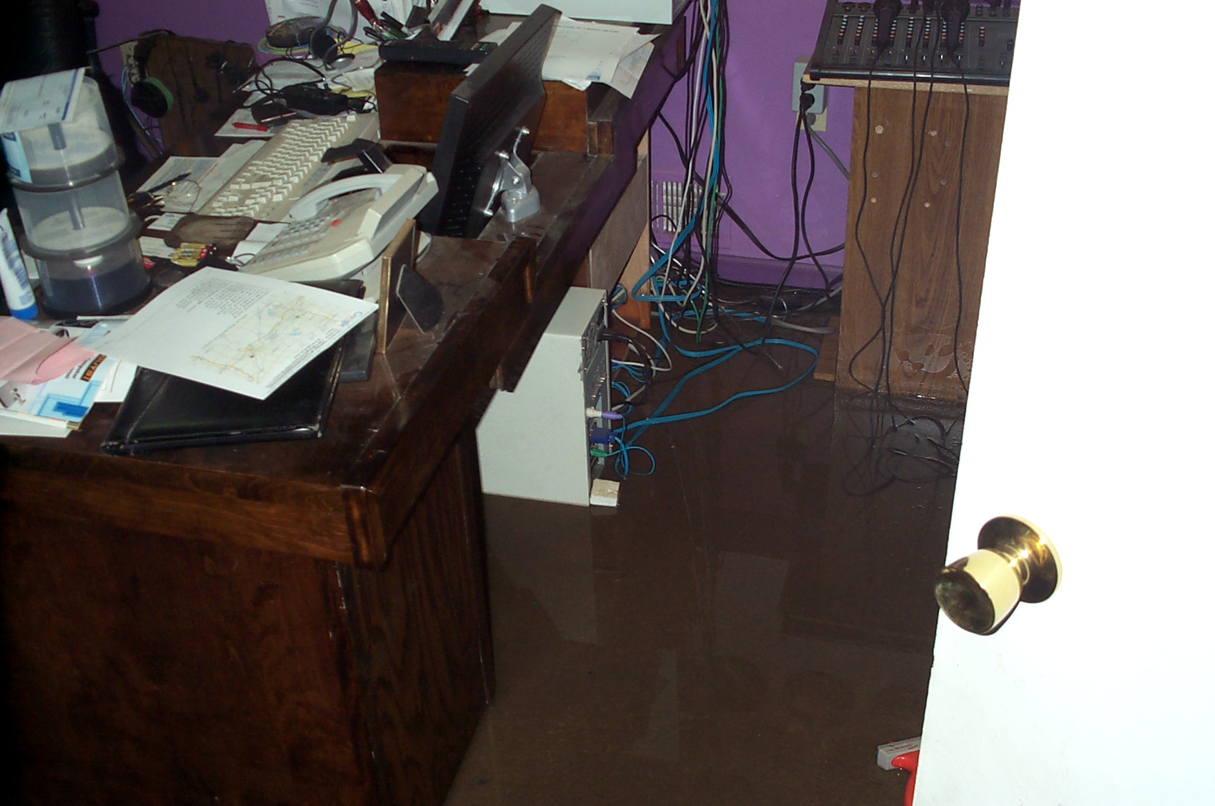

    This is what mine looked like after the sewer backed up last summer.
