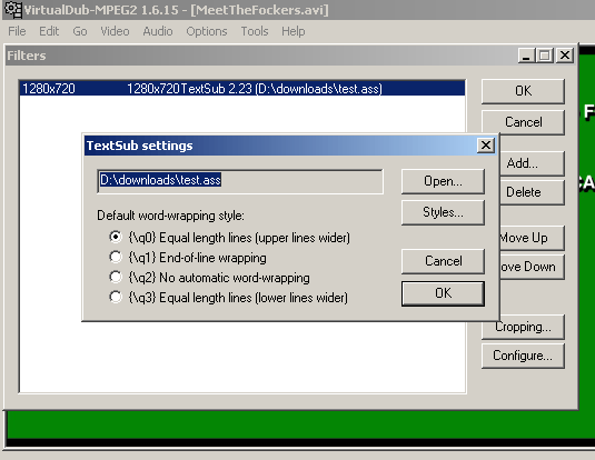

I could load .ass files fine with Vobsub 2.23 using the included TextSub filter in Virtualdub. You could also export to ssa in Aegisub.
Thank you Baldrick! I have to admit that I hadn't tried it with TextSub because .ass wasn't a format mentioned in the stickied guide. I had tried it with AutoGK though.
When I got up this morning and tried it in TextSub, I thought it wasn't working properly, but after loading the file back up in Aegisub, it was the same way; I lost all of the formatting! The font, font size, positioning, margins, coloring, and some of the lines of text were even truncated! So yeah, TextSub seems to be working fine for me. I guess I saved the subtitle file wrong in Aegisub or something....I'll have to figure out what's going on.

I don't know what happened when I saved the subtitle file the first time, but I tried it again and the formatting saved, so everything went through OK.
Thanks again, Baldrick.... -
