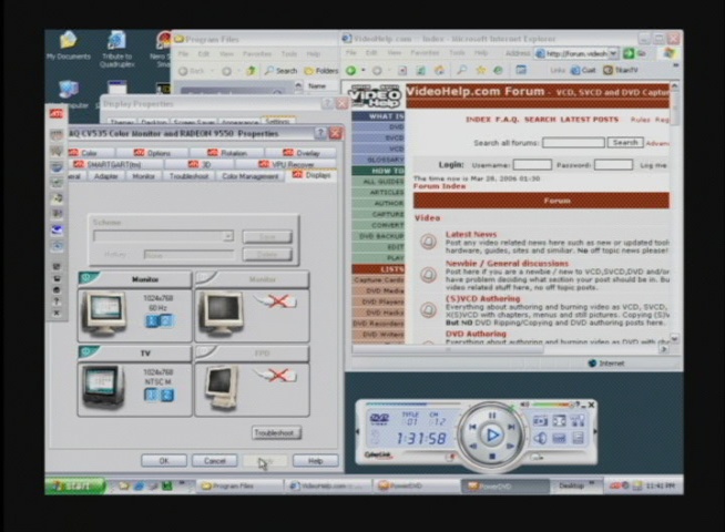

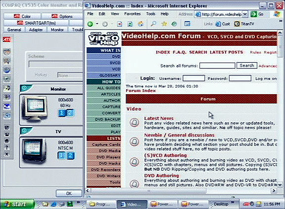

 The analog resolution of S-Video is similar to 640x480. The 640x480, 800x600, 1024x768 settings are sizing the desktop that will be converted to ~640x480 S-Video. As the desktop resolution goes up, text gets smaller and more difficult to read. 640x480 is difficult for layout. IMO 800x600 is a good compromise. Here is an example at 800x600 from an ATI 9550 over S-Video. This was recaptured by a Canopus ADVC-100.Originally Posted by sync
 1024x768 looked more like this

 Thanks for the explanation. Since 640x480 is too small on my current tv, 800x600 would only be worse. I did try it though and it was the same. So there is something I didn't do right.The 640x480, 800x600, 1024x768 settings are sizing the desktop that will be converted to ~640x480 S-Video. As the desktop resolution goes up, text gets smaller and more difficult to read. 640x480 is difficult for layout. IMO 800x600 is a good compromise.
