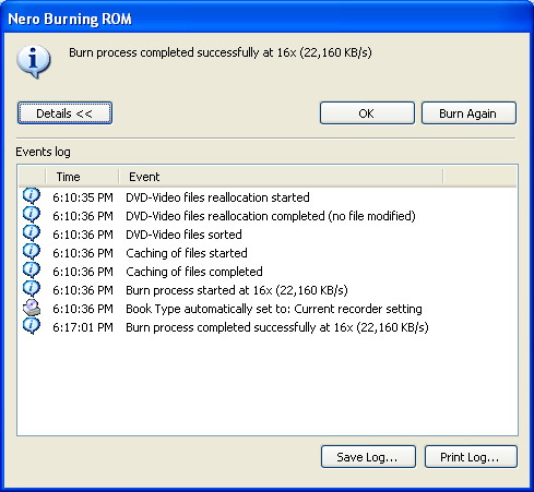

I reinstalled Nero and things are looking up.
As you can see the time for a ~4.7 Gb dvd took 6:26 minutes.
Not under the 6 Minutes that your referenced link earlier suggested though.
It turns out that the lead-in takes 17 seconds and the lead-out 31 seconds.
Thats obviously 48 seconds of time.

~six minutes sounds about right. I don't think that's a exact number from that chart. There's not a lot of speed difference between 16X and 12X. I've tended to reduce from 16X to 12X lately, even though I've had no problems with 16X with TY media.
If you are using that Nero mod that shows the speed variations during burning, it moves around quite a bit. I've never seen it stay anywhere near 16X, usually 9X or thereabouts, depending on what part of the DVD it is burning on. As long as it's not stuck on 4X, I would say it's good.

I do see towards the end of the burn it approaching 16x but thats ok, burning around 6 minutes is alot better than the 23-25 minutes I was getting.
I would like to find out if the lead-in and lead-out time could be cut down some but not something I am going to try and figure out right now. Just happy with this being fixed
