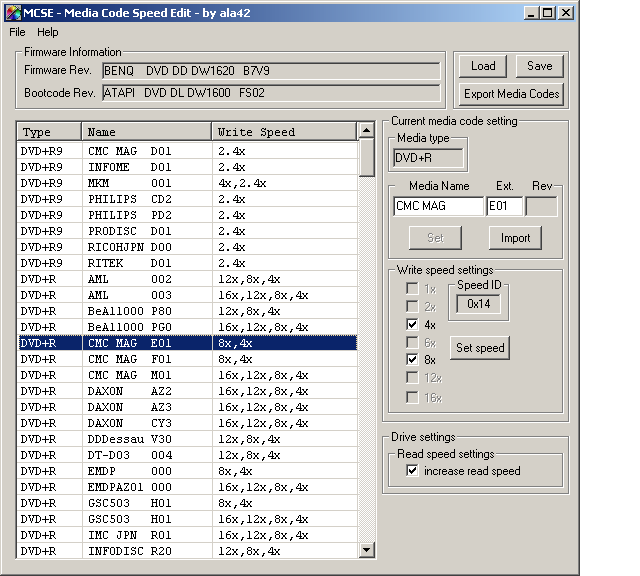

You mentioned you used MEDIA CODE SPEED EDIT.Originally Posted by strahd_zarovich
Look at this screenshot of MEDIA CODE SPEED EDIT.
Did you check off the box where it says, "INCREASE READ SPEED"?????????????
