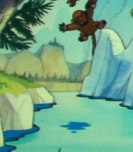

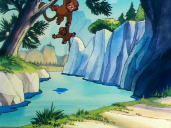

I have two videos from the same japanese anime, but one has the colors a bit blurry and worn out (pic : http://i10.tinypic.com/4cw4hnc.jpg) and the other has better colors (pic : http://i12.tinypic.com/3ypjj8p.jpg).
Now, using filters in virtual dub, or other software, how can i make the video with uglier colors look the closest possible with this one with better colors, of course i already tried some of virtualdub's fiters like HSV adjust and Levels, but it never looks similar and i would take forever to find the correct settings.

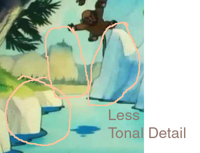

I like ColorMill. You still have to adjust by hand, but it has a good range of options. There doesn't seem to be a huge difference in tonal, although one is certainly duller than the other. I would start by upping the brightness a little, and also pushing up the saturation. Work in small increments until you are happy.
Read my blog here.
Is the objective to restore the image to original color values or to adjust it for your personal preference? The first picture 4cw... is closest to the original in colors but shows some blurring from transmission or compression loss. But the image is close to broadcast or DVD levels (i.e fits almost exactly to 16-235 gray scale). It also contains gray scale tonal values that are missing in the second picture.
The second picture 3yp... has been scaled to 0-255 levels but contrast was adjusted further causing white and black compression at the extremes and fewer levels of gray. This causes detail loss in bright areas like the mountain sides, mountain snow and river bank. Picture two has more resolution and may have been sharpened but contains far fewer gray scale levels.
Picture 1 has been cropped and resized up vs. picture 2. This may have caused the blur.

But the colors of the first are closer to correct for DVD and closer to the original. Picture 2 has been over-adjusted for contrast.

Quote "But the image is close to broadcast or DVD levels (i.e fits almost exactly to 16-235 gray scale). It also contains gray scale tonal values that are missing in the second picture. "
Now i seen the edited pics you show and indeed i already noticed this. See this is why i want a filter to apply similar colors to that one i said it's nice but without losing those tonal values you speak of, which i already noticed. I hope that colormill doesn't do this losing of tones... -

Picture one is scaled for 16-235, picture two has levels pushed out to 0 and 255. -

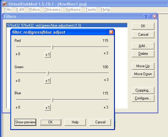

RGB Adust filter in VirtualDub:
http://neuron2.net/rgb.html
Black level could stand to come down a bit more for TV. -
wow !! I tried rendering the whole episode with the rgb filter like this, and it WORKS !! This is EXACTLY what i want, better colors WITHOUT loss of quality ! Thanks a lot, you saved me HOURS of work

hey jagabo, i need your help again. I mean how exactly you found those rgb settings, you had to manually move the sliders until you found a close resemblance ? Is that the only way to do this? It's because i need to find the correct values for other videos that i want to do besides this one, and i need to know if you used some kind of extra tool to find the correct values, of if it was just by trial...
Yes, I basically just moved the sliders until it looked right. But I got some idea of needed to be done by looking at the source image. I could see that it was too green (things that I thought should be white were greenish) so I knew that I would either have to reduce the green or increase the red and blue.
