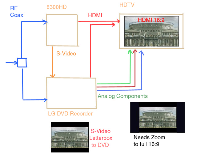

Trying to follow. HDMI upscale is for viewing a normal DVD upconverted to and output as 16:9 HDMI to the HDTV. If the DVD is widescreen, the 16:9 frame should fill the 16:9 screen but many movies are the wider 2.35:1 ratio so these will cause some letterboxing. 4:3 DVD material will be centered in the 16:9 frame.Originally Posted by ctowndu33
On the recording side, you will usually get best results from the S-Video output of the cable box. Since HDTV is always 16:9, the S-Video input will be recorded as SD 720x480i with 16:9 inside a 4:3 frame like this.
It would be better if it was full height widescreen format, but they don't offer that out the cable box. So, when you play this image back to the 16:9 TV, you need to use the zooming tools on the player or TV to enlarge the picture to fill the screen. Otherwise it has borders on all four sides.
The LG box cannot receive HD channels from cable using it's internal tuner. You must use the cable box tuner.

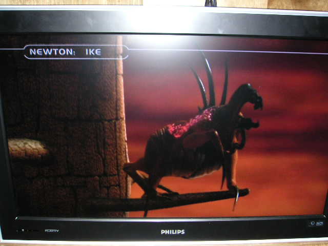

Can you post a picture? Even if just a camera snapshot off the screen.Originally Posted by ctowndu33 -

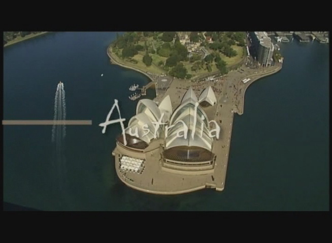

I could use the S-video out -> S-video in but it kinda sucks since the S-video in on the LG is in the front. I guess I can try different ways of hooking it up and see if they are better. I can try the S-video and also outputing from the LG over component when I am not upconverting a DVD. Here is a picture, maybe this will shed some light on it for someone to help. Thanks again everyone! This picture is HD 1080i on the cable box with a regular coax cable hooking the 8300 to the LG and then an HDMI hooking the LG to the TV.
What you have there is letterbox 4:3 horizontally expanded (people get fat). What you need is a H and V zoom to expand the image to fill the screen. Analog component should look better than S-Video for DVD to HDTV connection.

What you have in your snapshot is this ... H-Stretch only.

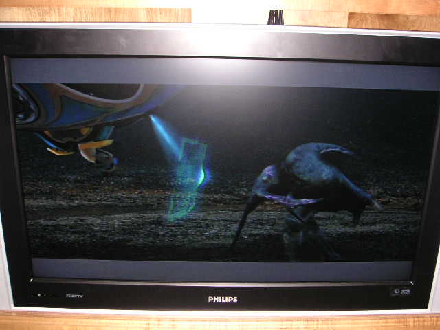

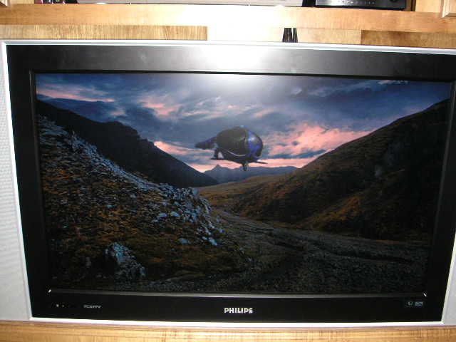

The SA8300HD cable box will pass a full screen 16x9 image (at 480i) from an HD channel when using the component output. In order for this to work you need a DVD recorder with component inputs. Unfortunately most do not have component inputs. Here is a pic of an HD channel at 480i output via component to a Polaroid 2001G DVD recorder that has component inputs:
Here is the same channel via svideo out from the SA8300HD cable box into the Polaroid's svideo inputs. Notice the grey bars:

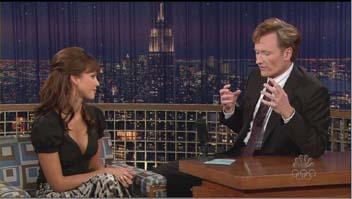

If you have a DVD recorder with just svideo inputs an option is to convert the component output from the SA8300HD to svideo. In this pic I am using the Polaroid 2001G to convert the component signal to svideo. The pic shown is from a Toshiba DVD recorder and the image is from the Toshibas svideo input.
So again with the SA8300HD you need to be able to take advantage of its component output for full screen recording from an HD channel (at 480i). -

I prefer the component to component PQ but you really do not lose much with the component to svideo conversion using the Polaroid. I doubt if anybody could tell.Originally Posted by ctowndu33
There are converion boxes sold that do this but run around $300. The Polaroid does the same thing and it has an LSI Domino chipset which I think is one of the reasons why the conversion has excellent PQ - for much less $'s by the way. The quality going the conversion route is significantly better than using the zoom approach.

Your first pic above - the 4x3 one is an example of not having the widescreen flag set. It is not anamorphic. In my post above I mentioned a Toshiba. The Toshiba sets the widescreen flag when recording. I use it for this purpose if I want playback to be correct on a 4x3 display. -
