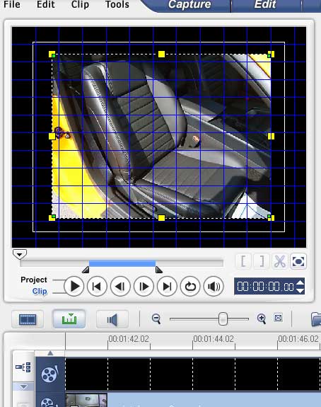

My WMV files were 320x240 and of low quality. I simply placed my WMV files in the overlay track and put a solid black color in the normal video track. I then sized my WMV (with the mouse) so I had some black bars all the way around them. I then right clicked on the screen then click 'keep aspect ratio' and 'anchor to center' to make it all correct. Easiest way to resize I have found....
