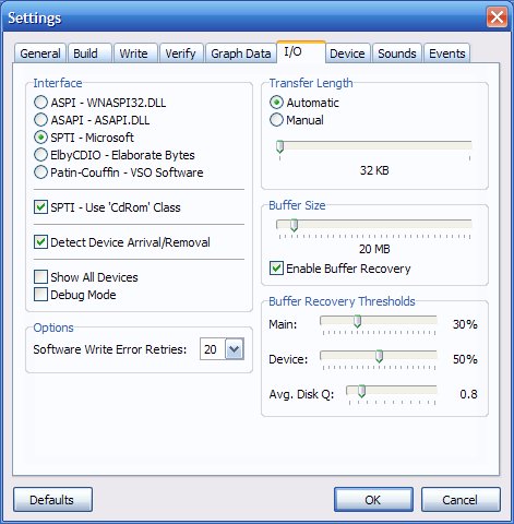

  8. Today I burnt one DVD video image using ImgBurn- to my sheer ashtonishment [and horror] that the Data Verification completely faild . Though the video ran without any hitch in my Stand Alone DVD player. Do you think that this has happened because of the ASPI layer?
    BTW, ImgBurn Data Verification results are very accurate in nature, before this I never found a burnt disk worked even afte Data Verification Results of ImgBurn failed.
    I have searched the web I think of going back to 4.60 too.
    What say you?
    Thanks for your replies

  9. Member MysticE's Avatar
    Nov 2003
    On my sp2 rig I don't even have ASPI (Adaptec) installed. Nero ASPI is there, but that is just part of Nero.
    Seems most XP applications use MS' SPTI.
    I have two burners- liteon DVD burner and LG CD burner. DVD burners firmwire is the latest. The problem I faced is that the Lite On sometimes could not recognize the CD as a media to write and sometimes burn failure.
    Is there a reason why you think this is ASPI related? If you use Nero will it work?
    Do you have ImgBurn set up to use SPTI?
  10. Hello MysticE
    thank you for taking time to answer.
    I have used NERO and it does work properly.
    I have also checked the configuration of ImgBurn, and the ASPI selected is of MS.
    BTW, I have reverted back to 4.60.
    Thank you again.
