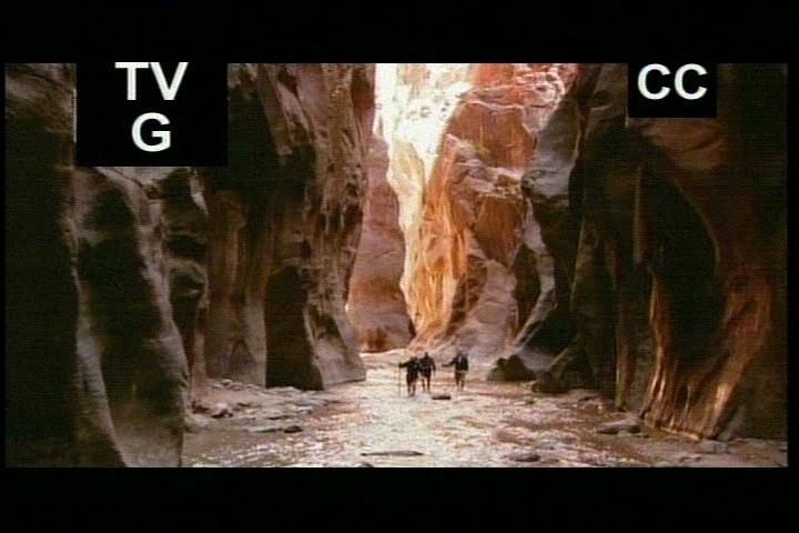

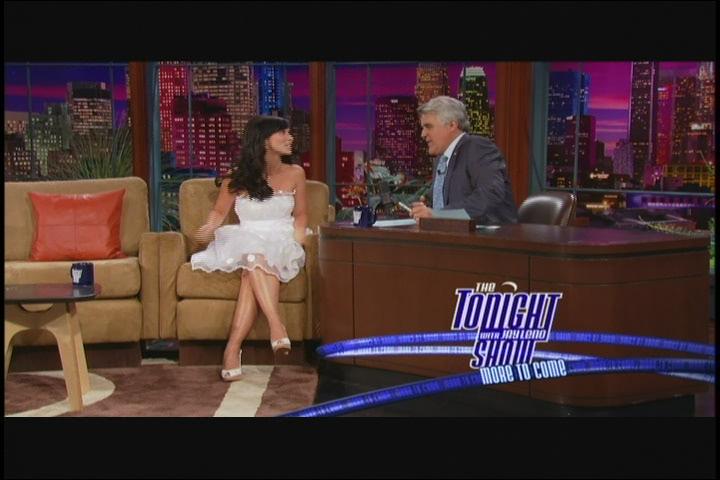

    Much better with the ADVC but be prepared for 13.5GB/hr file sizes.
    I do this a lot for material I want to later encode for DVD. The results from the S-Video out of the cable HD cable box are particularly good.
    A sample
    HD-->S-Video analog-->ADVC
    SD-->S-Video analog-->ADVC
    SD movie channel

    Yes what Bob says. This it a Comcast Motorola HD box DCT-6xxx (6200 this one) downconverted to 480i S-Video out then captured by the ADVC.
    Ideally the cable box would output the full height 480i that would be in true wide 16:9 mode, but it doesn't. Only letterbox is available.
    It should offer a widescreen mode like this that could be authored as true widecreen 16:9.
