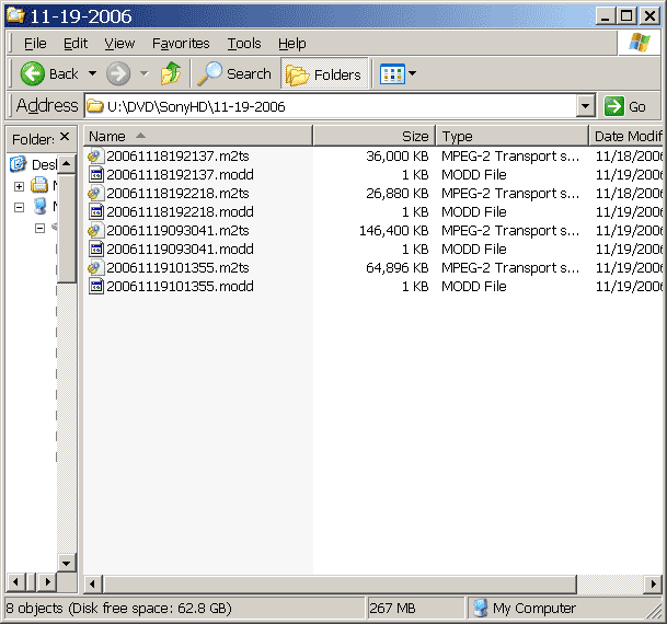

Sorry if I wasn't clear as there was a ton of info I was trying to pass in a short post. The HDR-SR1 creates MPEG-4/H.264 files, but they are named with the .m2ts file extension. Strange, I agree, but I've created a screenshot of some of the file names created by the SR1.Originally Posted by bobkart
