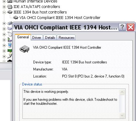

Is your IEEE-1394 port on the motherboard or a PCI card? Has the port worked with another device?
You should have the following or similar in your device manager. Is it working properly?
You might want to delete this and let it reinstall on reboot.

OK, I tried the website with no luck, I deinstalled the drivers to the IEEE card and installed them again. No luck. What am I doing wrong?
