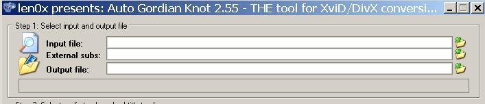

    I have a problem... when I press CTRL-F8, nothing happens.
    Is there another way to get around this?
  19. Assuming you have an up-to-date version of AutoGK, when you press CTRL-F8 the new line doesn't pop up between the Input File and Output File? Otherwise I know of nothing short of uninstalling and reinstalling AutoGK, which often serves to fix any problems.

    Can someone help me?
    I tried to hadsub srt but the result is only 50mb even though I put custom size the same as source size, moreover, the video is blank grey screen.
    here is the log
    [03/08/2012 17:12:10] AutoGK 2.55
    [03/08/2012 17:12:10] OS: Windows Vista (6.1.7601).2
    [03/08/2012 17:12:10] Job started.
    [03/08/2012 17:12:10] Input file: C:\Users\Pavilion\Downloads\Tian Long Ba Bu (2003)\Tian.Long.Ba.Bu.2003.11-40.dvdrip.avi
    [03/08/2012 17:12:10] Input codec: XviD
    [03/08/2012 17:12:10] Source duration: 47mn 40s 40ms
    [03/08/2012 17:12:10] Output file: C:\Users\Pavilion\Videos\Tian.Long.Ba.Bu.2003.11-40.dvdrip_agk.avi
    [03/08/2012 17:12:10] Output codec: DivX
    [03/08/2012 17:12:10] Audio 1: 117 Kbps CBR MP3 2ch
    [03/08/2012 17:12:10] Subtitles: from external file: C:\Users\Pavilion\Downloads\Tian Long Ba Bu (2003)\Tian.Long.Ba.Bu.2003.11-40.dvdrip.srt
    [03/08/2012 17:12:10] Format: AVI
    [03/08/2012 17:12:10] Target quality: 100%
    [03/08/2012 17:12:10] Audio 1 settings: Auto
    [03/08/2012 17:12:10] Started encoding.
    [03/08/2012 17:12:10] Source resolution: 576x320
    [03/08/2012 17:12:10] Source fps: 25
    [03/08/2012 17:12:10] Analyzing source.
    [03/08/2012 17:16:40] Source has percentage of interlacing in motion areas: 0.00
    [03/08/2012 17:16:40] Source is considered to be progressive.
    [03/08/2012 17:16:40] Output will contain 71501 frames
    [03/08/2012 17:16:40] Demuxing audio.
    [03/08/2012 17:16:53] Preparing subtitles.
    [03/08/2012 17:16:53] Running single pass encoding.
    [03/08/2012 17:16:53] Writing the following script to C:\Users\Pavilion\Videos\agk_tmp\Tian.Long.Ba.Bu.2 003.11-40.dvdrip_agk_movie.avs
    LoadPlugin("C:\PROGRA~2\AutoGK\DGMPGDec\DGDecode.dll")
    LoadPlugin("C:\PROGRA~2\AutoGK\filters\autocrop.dl l")
    LoadPlugin("C:\PROGRA~2\AutoGK\filters\vsfilter.dll")
    LoadPlugin("C:\PROGRA~2\AutoGK\filters\RemoveGrain SSE3.dll")
    movie = DirectShowSource("C:\Users\Pavilion\Downloads\Tian Long Ba Bu (2003)\Tian.Long.Ba.Bu.2003.11-40.dvdrip.avi",25).KillAudio()
    movie = isRGB(movie) ? ConvertToYV12(movie) : movie
    movie = isYUY2(movie) ? ConvertToYV12(movie) : movie
    cropclip = autocrop(movie,mode=0,wmultof=4,hmultof=4,samples= 10,aspect=0,threshold=0,samplestartframe=0,leftadd =0,rightadd=0,topadd=0,bottomadd=0)
    fixed_aspect = 1
    c_width = width(cropclip)
    c_height = round(height(cropclip) / fixed_aspect)
    input_par = float(c_width)/float(c_height)
    input_par = (input_par > 1.4) || (input_par < 1.25) ? input_par : (4.0/3.0)
    out_width = 576
    out_height = round(float(out_width) / input_par)
    hmod = out_height - (floor(out_height / 16 ) * 16)
    out_height = (hmod > 4) ? (out_height + (16 - hmod)) : (out_height - hmod)
    new_aspect = (float(out_width) / float(out_height)) / fixed_aspect
    autocrop(movie,mode=0,wmultof=4,hmultof=4,samples= 10,aspect=new_aspect,threshold=0,samplestartframe= 0,leftadd=0,rightadd=0,topadd=0,bottomadd=0)
    LanczosResize(out_width,out_height)
    TextSub("C:\Users\Pavilion\Downloads\Tian Long Ba Bu (2003)\Tian.Long.Ba.Bu.2003.11-40.dvdrip.srt")
    [03/08/2012 17:19:08] Duration was: 2 minutes 14 seconds
    [03/08/2012 17:19:08] Speed was: 533.40 fps.
    [03/08/2012 17:19:08] Job finished. Total time: 6 minutes 58 seconds
    Thanx in advance
