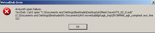

I tried using the *.idx file at the CTRL+F8 section, then the *.sub. But they both get me to the same result: an error pop-up that says:
"Avisynth Open Failure. DirectShowSource could not open as video or audio. Video returned: could not open file *.avi: no combination of filters could be found to render the stream. Audio returned: DirectShowSource: RenderFile, the filter graph manager won't talk to me."
I also want to specify that the film itself works fine on my computer. I just want to put the subs and the video file together.
What to do now?

The problem isn't the subs, but the AVI itself, the video and/or audio. I don't know what exactly is the problem, but anytime you download something you take a chance on getting back what you paid - nothing.
You might try uninstalling and then reinstalling AutoGK (and upgrading to the more recent ver2.48 in the process), but other than that I have no idea what's wrong and can only suggest that you try a different program. -
Ano. This is my first time trying this and I have to say that I keep getting an error! Something on the lines of this:
Is there anyway I can fix this? -
There are 2 kinds of .sub files, the text based one and the image based one that also comes with an .idx file. The error means VDub was expecting the text based kind of .sub file. To get the IDX/SUB files into AutoGK you use the drop-down box to get them, and not the first line you see, which is only for text based subtitles.
Did you create external subtitles (in the Advanced Settings)?
If you don't know or don't understand, post the log. -
