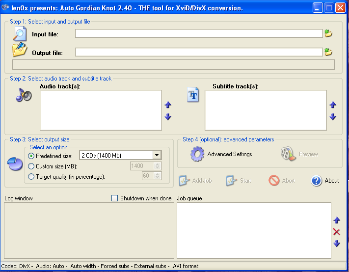

can you help me....
i want to add permanent subtitle to avi....
i've download AutoGK but when i press F-8 nothing change....
FYI there is a subtitle track in AutoGK but there is no option for subtitle.
i cannot choose subtitle....u can see the picture below.please help me guysssssss
autogk.bmp -
