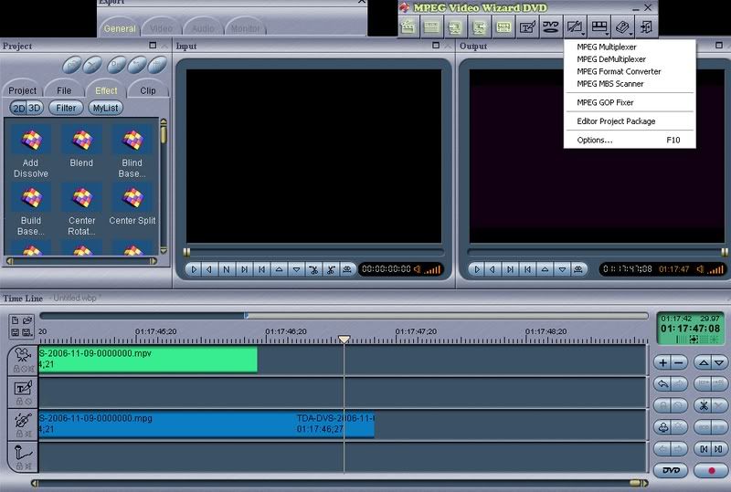

heres the end of the movie see how the video is off? i tryed to fix it by moving the video so it would be on, but then the begining goes off. can you guys Recommend any program that can split(demultiplexer) the movie with out having this problem?

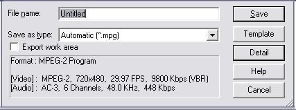

no im doing a auto convert. heres the format info
