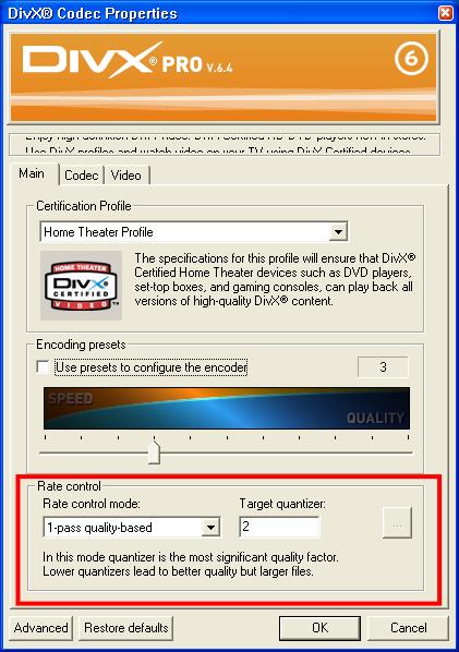

Best quality: 1 pass quality based, target quantizer = 1. The file probably be bigger than your MPEG2 source though.
Target quantizer = 2 will give you video that's nearly indistinguishable from the source even if you look at enlarged still frames. But the file size will still be pretty large -- a little smaller than the MPEG2 source.
Target quantizer = 3 will give a little macroblocking if you look at enlarged still frames. It won't be noticable at normal playback speeds. The file size will be significantly smaller than the MPEG2 source.

Where is the quantizer setting located? I see an encoding preset with numbers ranging from 1 to 10. It looks like I need something between 2 and 3. A good balance between quality and filesize.Originally Posted by jagabo"EL EXTRANJERO ME SIENTO"

You may also have to consider a few other things. All the following is based on using quality based (target quantizer) encoding (much of it also applies to birate based encoding):
If you want every frame to be encoded with the same quality disable Bidirectional Encoding. B frames are normally encoded with a larger quantizer. Disableing bidirectional encoding will make the output file larger.
Since your source isn't square pixel you will want to resize to a 4:3 frame size (eg, 640x480) or use MPEG4's display aspect ratio (DAR) setting. I don't think Divx allows you to set the MPEG4 DAR but you can add it later with MPEG4Modifier. That is, just compress at 720x480, then use MPEG4Modifier to set the DAR to 4:3. Note that not all players will support DAR so resizing may be preferable. Use the Lanczos4 filter if you use Divx's built in resizer.
As far as speed is concerned, using Encoding Mode (on the Codec tab) higher than Balanced will take longer to encode but only give slightly smaller file sizes. For example, going from Balanced to Insane may take 4 times longer to encode but only produce a 5 percent smaller file. Since we are talking about constant quality encoding both files have the same quality, the higher setting is just able to squeeze the file size a little more and still maintain that quality. As far as I can tell this setting only controls the motion search precision.

Target quantizer = 2 made a filesize almost equal to the original. Going to Target quantizer = 3 made a filesize 63% of original. The quality is not as good as I would like but it good enough and the encode time is only 70 minutes for 30 min video. Not too bad.

jagabo, I am going to stick with target quantizer = 2. Now I can save 50% encode time and get better quality than the default Divx settings with a 63% filesize of original. The Divx people should learn from this. Thanks a million.
