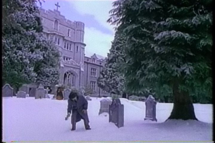

This is the before shot of a VERY noisy SVHS video

This is interlaced movie? Does this filter can be used on interlaced material?
Yes, that was an interlaced movie. It was originally recorded from commercial c-band satellite equipment via the composite inputs, to SVHS tape, in ep mode. There is LOTS of noise present and the tape is 15 years old. While neatvideo does not really intend that their filter be used for interlaced video, it still seems to work very well on interlaced stuff.

The video actually looks fine, can't see any problems with it due to interlacing. Slow is an understatement, this thing crawls, but the time it took was at least well worth the end results. Check the neatvideo forum for more info on using it on interlaced material.
I've had no problem using NeatVideo on interlaced material. At great, time-consuming trouble I tried de-interlacing but found no difference in the results. A video using a combination of interlacing and telecine is more trouble than it's worth, so I leave it as-is. BTW, the filtered sample shown above is overly filtered and looks plastic; I would have reduced the filering a bit -- but, then, it all depends on your preferences.
