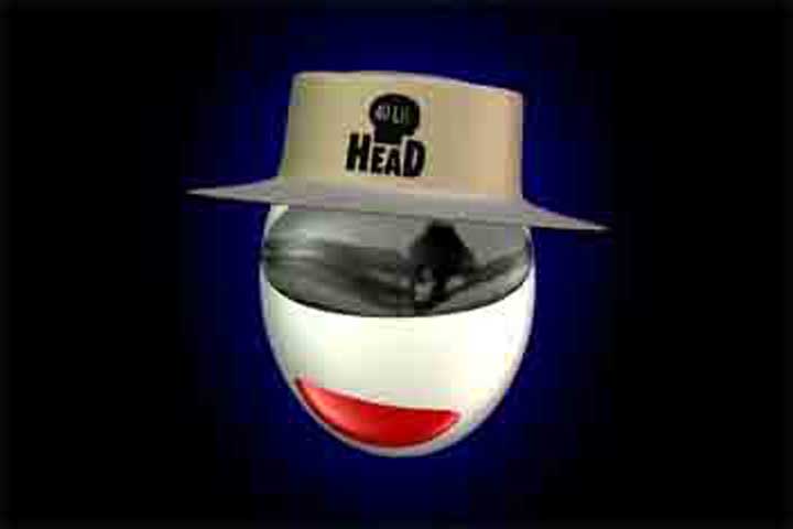

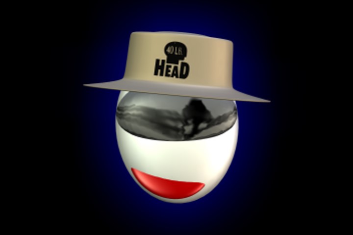

    Here is an explanation using images, these are not from video but the same principals apply you start with a 720x480 image (meet headbot :P ):
    You scale it down and lose resolution:
    You scale it back up:
    The software has to "guess" what belongs there. How well it works depends on the software you are using. Some methods work better than others. On the image side of things there is a few applications that will examine the image and attempt to find the edges and fill the solid areas which will give you better results that you see above but that will only preserve edges, it won't replace what was in the original image. There was a video filter that worked in similar fashion mentioned in the News forum not too long ago.
    The bitrate is dependant on the resolution, too little and you introduce artifacts. Use too much and you're just creating a larger file but it certainly won't affect the quality of the file. Again some images,
    Taking the image above (9KB):
    Compressing it to about (3KB), this would be the equivalent of reducing the bitrate on a video:

    To take it to the next step, here is your image reduced in resolution and bitrate to approx what you have now, then resized back to 720 x 480.
    Notice how adding the extra resolution doesn't add quality, and in fact makes the flaws in the original even more pronounced
