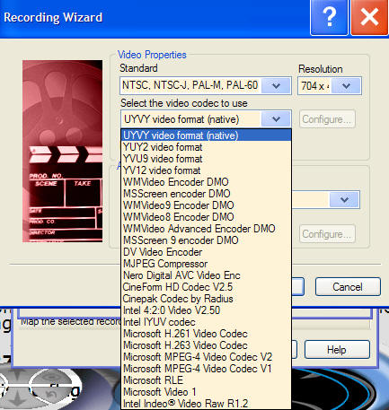

Uncompressed UYVY video in an AVI container has no field order flag. Any program that deals with it has to figure out the field order, guess, or assume. Who the **** knows why Vegas sometimes decides on one, sometimes another? And who CARES? Just figure it out for yourself, set the source field order in Vegas and encode. It's as simple as that. We've been telling you this for days now.

When did you shift to uncompressed capture in MMC? What are you capturing?

I thought I only had Encode Interlaced, Deinterlace and Progressive options, period. I was unaware of other problems that can exist.
4. I then realized I needed to edit this show more so I captured it to avi and erased it from my DVR.
THEN:
5. AVI which has no flags was converted to MPG with the same results as when I captured the show to mpg. Encode Interlaced was unstable no matter what.
