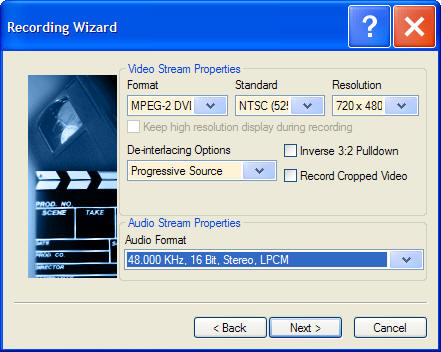

    I use TmpgEnc DVD Author to produce my DVD's.
    I usually capture to Mpeg-2 720x576 at a pretty high bitrate using my Leadtek WinFast Capture card. Anywhere from 8000 Kbps to 9800 Kbps. Anyway when i load the finished Mpeg's into TmpgEnc it always comes up with this message that the combined bitrate is too high and this will produce an out of standard DVD that might not be compatible with some DVD Players.

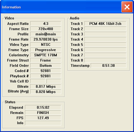

  12. Senior Member c627627's Avatar
    Kansas
    Check this out, I captured a file at 8020 kbps, and look at how different apps are telling me what the actual video capture bit rate was:

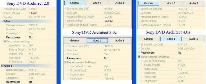

  13. Senior Member c627627's Avatar
    Kansas
    Having discovered jut how wrong the software can be in detecting the actual video capture bitrate and seeing that it can be off by a 1000 kbps or even 1500 kbps (!), these are my conclusions:

  15. Senior Member c627627's Avatar
    Kansas
    Right, so according to Bitrate Viewer pictured in the post above yours, 7372 kbps was the peak bitrate even though I captured at constant 8020 kbps, is that the way to read it?
    Even though Bitrate Viewer also says that Nom. bitrate: 8020000 Bit/Sec
    Does that mean that since 8020-7372=648, the actual video captured bitrate was off by 648 kbps, and that if I chose to recapture the same content, I could add that much to previously set 8020 kbps?

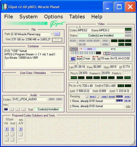

  16. Always Watching guns1inger's Avatar
    Apr 2004
    Miskatonic U
    What bitrate viewer is saying is that your video has a peak bitrate of 7372, and average bitrate of 6156 kbps, but the encoder wrote your chosen CBR bitrate of 8020 kbps into the header.
    I have a programme stream on my disk at the moment that is directly taken from an OTA digital broadcast. No extra encoding etc. The stream header (and bitrate viewer) both say the nominal bitrate is 10000kbps. Which is patently untrue as the 1:28:14 running time fits comfortably on a DVD5 when authored.
    Using a bitrate calculator with a custom size option, I get an average bitrate of around 6278 kbps to reach the actual file size I have.
    Bitrate Viewer reports a peak of 8426, and an average of 6265.
    G-spot 2.60Beta1 reports and average bitrate of 6309.
    A quick look at DLP's bitrate viewer showed similar numbers, but also included the audio bitrate. I didn't let the scan finish, so I won't publish the actuals.
    Bottom line - none agree, all ballpark. The nominal bitrate as stored in the mpg file proved to be meaningless.
    So what does this mean for your file ?
    You asked for 8020 kbps, so that is what your encoder put in the header. In reality, it could not maintain that as a CBR encoding, and appears to have been unable to encode at a constant rate, period.

  17. Senior Member c627627's Avatar
    Kansas
    .mpg file was captured using ATI Multimedia Center, software set Constant 8.02 M Bit/sec video bitrate.
    I'm not sure I understand your post. What is the actual video captured bitrate of the file?
    What would you use looking at the Bitrate Viewer screenshot as the video bitrate if you had to recapture the same source?
    In other words, if 7372 is reported as peak and I set 8020 constant, does that not mean that the video bitrate could be actually increased because the capture program is undershooting the set constant bitrate?
    Can you believe how wrong Sony DVD Architect 2 and 3 are? They are reporting off the charts high bitrates for the same file and are warning it will not be compatible with DVD players if encoded as such?!
    Here's another screen shot of it:
  18. Always Watching guns1inger's Avatar
    Apr 2004
    Miskatonic U
    G-Spot is almost exactly the bitrate you asked for - does this mean that BitRate Viewer is way off as well ?
    This is why, when people ask which program to use to determine the bitrate of an mpeg file, they are told that none of them can be trusted.
    If I feed the file size and length into a bitrate calculator, then select 1536 kbps audio, I get an average bitrate of 7969 kbps, which is closer than bitrate viewer got, but still less than G-Spot.

    Thanks for the advice. I just want to say that so far, I have only used constant bitrates because I usually capture shows that are under an hour.
    I didn't know the exact length of the show but I knew it was under an hour, allowing for high bitrates even with wav audio.
    10080 dvd spec - 1536 kbps wav audio = 8544 kbps
    So I knocked off about 500 kbps for this and captured at 8.02 Mbps.
    I retrospect, I should have used 448 kbps Dolby Digital AC3 audio:
    10080 dvd spec - 448 kbps AC3 = 9632 kbps.
    I would have then used, maybe 9100 kbps for video.

    1. Ignore any app that spits out a bitrate without running the entire clip through.
    2. Even when apps analyze the entire clip, variations between them cast doubt on accuracy, so I believe it then comes down to this statement:
    Originally Posted by Nelson37
    Your "cushion factor" of approx 500 is not large enough to account for the possible variance, I would double it.
    The best you can do is an educated guess.
    I'm leaning towards an opinion that the size of the protecting buffer ("cushion factor") would depend on the capture card itself. Older cards may fluctuate widely going above the 500 kbps cushion factor.
    P.S. Following manono's advice, I found DGMPGDec Version 1.4.8 (which is the DGIndex app) and it ran the entire 52 minute mpg file in 15 minutes to show the Bitrate (Avg) being 8.020 Mbps, spot on. (By the way, this was a clip I captured from a High Definition channel, that's why the frame type was set to 'Progressive' instead of 'Upper Field First' ATi cards usually require for captures.)
    But anyway, Bitrate Viewer is popular and widely praised so it is strange that it is showing considerably lower actual average video bitrate for the same file.
    That is why I think that "an educated guess" means having some experience, knowing your capture card and lowering the set video capture bitrate by the amount specific to you.

    Hm. I capture to burn to DVD to watch on both standard & HD TVs.
    You mean CHECK: Inverse 3:2 Pulldown for Progressive?
    I usually have it
    • 'Encode Interlaced' for Standard TV source or 'Progressive Source' for HD signal source
    • UNCHECK: Inverse 3:2 Pulldown
    but for a High Definition signal, I should CHECK: Inverse 3:2 Pulldown?
