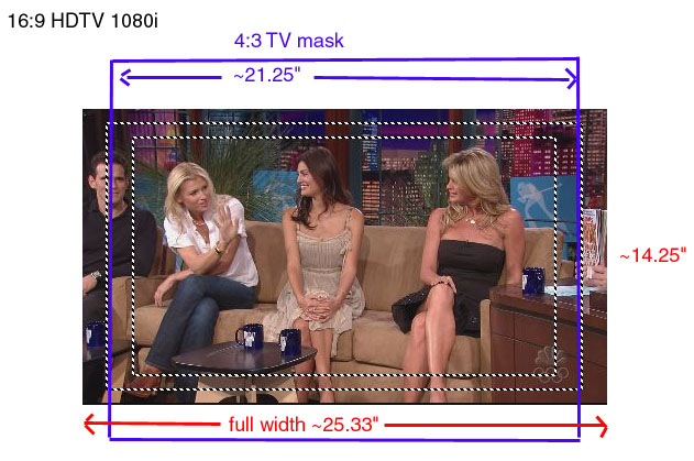

    since we're into the calculations... if I wanted to get a 16:9 screen that was just as tall as my 27" 4:3, but wider of course, what diag size would it be?
    33" 16:9 = 27" for 4:3
    Screen Size Calculators:
    http://reviews.cnet.com/4520-7608_7-1016109-4.html
    http://www.cavecreations.com/tv2.cgi
    http://www.creekstonesystems.com/tv/Default.aspx
    Viewing Distance Calculator:
    http://www.myhometheater.homestead.com/viewingdistancecalculator.html
  27. Member
    Jan 2007
    33" w=28.8 h=16.2
    466.56 sq inch area

    Many people are going overboard when it comes to screen size. They replace a 27" 4:3 set with a 50" 16:9 HDTV and then complain that SDTV doesn't look good. They should back up or scale down.
    At 7 feet, I can still see the scan lines on a 27" 4:3 SDTV CRT. Replacing it with a 32" 16:9 HDTV provides a nice balance between screen size and picture quality. SDTV looks fine. Widescreen DVDs look bigger and better. HDTV looks awesome.
