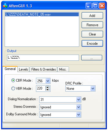

    The problem is that none of the freeware AC-3 encoders allow you to set the "special" parameters that can control the "volume".
    For instance you should first normalize your WAV file to -3.0db (to be safe) although technically you can normalize to 0.0db if you wanted (although cheap speakers like those built-in to a TV may not handle 0.0db audio well without distortion).
    Then in your AC-3 encoder you set it up to -31db for the Dialog Normalization setting and you set the Dynamic Range compression to NONE (also no RF Modulation compression).
    That will give you an AC-3 audio file that has the same "volume level" as the WAV file.

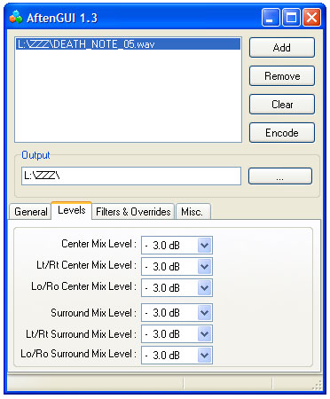

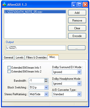

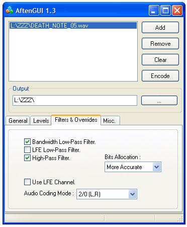

    I've never heard of this Aften program so I downloaded AftenGUI 1.3 (which appears to be the newest version) and unzipped it ... I also downloaded Aften 0.05 rev216 (which appears to be the newest version of the "core" program) and put it it in the same folder as the GUI files.
    This FREEWARE AC-3 encoder does have options like the more professional encoders ... I've never seen these options in other FREEWARE AC-3 encoders.
    Here is how I did it:
    The input was a 16-bit 48k 2 channel Stereo PCM WAV audio file that had normalization applied to -3.0db using GOLDWAVE ... one could do the same thing with Audacity which I mention since Audacity is FREEWARE whereas GOLDWAVE is not FREEWARE.
    I have to admit I am not "positive" as to the setting on the MISC. TAB so I left all that at the default settings but I'm pretty sure that for 2.0 AC-3 that all the other settings are correct.
    These settings I picked in Aften are based on my AC-3 encoding experience with the "Soft Encode" AC-3 encoder as well as the AC-3 encoder from Sony Vegas/SoundForge.
    For more info on AC-3 encoding there is an excellent guide in the AUDIO ENCODING FORUM over at the doom9 forums.
    - John "FulciLives" Coleman
