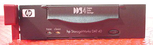

If your serious about achival backups , that last ... consider dat backup unit .
Replace the tape every 2 years is good advice , though we have had tape's stored for more than 5 years (writen once / stored as long term backups / never accessed) , recently tested , and all perfect .
