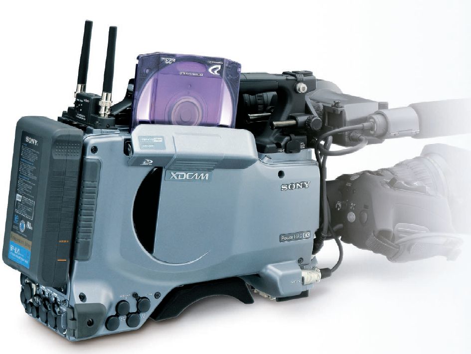

    Sony has a Pro XDCAM Bluray DVD recording line that will be popular for news editing because if solves the need for a interchangable cassettes that can be tracked by barcodes. It records in IMX or IMX HD which is an editable form of MPEG2. All this technology eventually shows up in the consumer models.

  11. With twin wip antenna at the back of the Sony XDCAM, isn't tha cam setup for live procast, instead of record ?
    The RF bay takes various modules. RF can be used for bi-directional audio, intercom (IFB), genlock for synching cams for multicam edit, or for feeding live video. Live video can be high quality for broadcast or preview quality so the director can see the shot. This includes the news director watching from the TV station over telco wireless or full bandwidth microwave.
    "Footage" can be sent live with proper links or slow streamed over telco. A compressed version can be sent first so editing can be started while the full resolution version is in the pipe.
