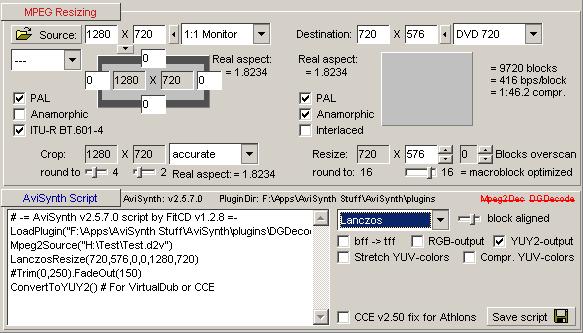

    Also Fulci, how do you make that FitCD program to work with a 50fps source. I think you have to add the FDecimate(25) or SelectEven() manually.
    I just added FDecimate(25) to the script and tested on a small clip and it worked fine.
    I'm now trying another source: 1280x720p at 50fps. FitCD crops a lot and I can't get the right aspect ratio. So I'm not cropping at all and resizing to full 720x576. Not too fussed if the TV overscan cuts some picture.

    FitCD doesn't crop at all for 1280x720 1:1 Monitor to 720x576 DVD 720 if you check the ITU-R BT.601-4 box and the PAL/Anamorphic boxes, and don't check the blocks overscan box.
    Oct 2006
    Australia
    I had to crop some off the top/bottom/sides. And when I did it resized to something around 640 wide, which is way too much
    Should I manually adjust the height ? It was around the 400 pixels. Can I make that bigger - say 540

    Anyways. I tried again, and this is what FitCD showed
    I think I was worried about the large borders top and bottom. That's because it's making a 4:3 DVD, yes ?
    If I want to make a 16:9 DVD I would Just select 'Anamorphic' ?
    I think that's what I want. As I am making 16:9 (WideScreen) DVD's
    This is what that gave me. Looks alright. Is 'accurate' the best option to use ?

  18. I don't understand why you'd need it.
    Because you keep making such idiotic statements as:
    You said yourself you did something wrong in FitCD, didn't you? Or maybe that was a different video? So, if you want some help with something, how about being specific about the video in question? One way to do that is to upload a sample.
    Do you have the Blocks Overscan box in FitCD turned on for 1 block for a reason? You don't need it. I don't see that you have to do anything but to resize for PAL 16:9 DVD. Maybe redistribute the black from just the top to the top and bottom:
    LoadPlugin("C:\Path\To\DGDecode.dll")
    MPEG2Source("C:\Path\To\test.d2v")
    SelectEven()
    Crop(0,4,0,0)
    AddBorders(0,2,0,2)
    LanczosResize(720,576)
    ConvertToYUY2()
    Don't use DirectShowSource. Make a D2V and use MPEG2Source.
    Yes, since the source is Hi-Def, I don't know why you'd even consider anything else.
