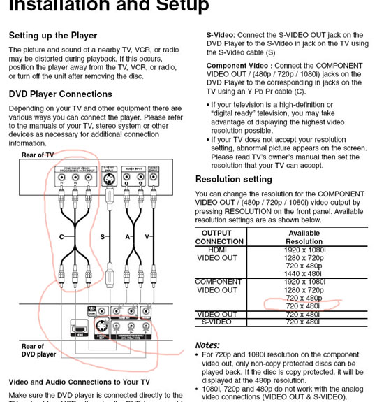

I have the dvd player hooked up to a Sony FS120 crt television. My problem is that whenever the scene is dark or black, the black looks mucky with distorted colors in it. I have the dvd player hooked up via component cables that were rather pricey. Any help would be great.

Do you have the player set for 4:3 YPbPr 480i ?

I verified that my tv was set to 4:3 and the dvd player is at 480i. I have had this problem when using a different dvd player and a different tv (same model). Should I post in another forum for tv problems?

If all the settings are correct and other players do the same thing, it may be a problem with your TV's internal adjustments rather than the DVD player. Do you see similar problems from S-Video or TV tuner inputs?

I've come to the conclusion that it is the tv. I'll just have to buy another one. I had bought this same model before and it did the same thing with a different dvd player. I don't notice it on s-video.
