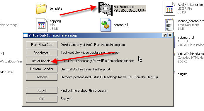

    So let me make sure I got this right, I open the video file, add filters, start frameserving, save vdr file, open tmpgenc, begin encoding with tmpgenc, frameserver should begin counting frames and tmpgenc should be encoding the filtered video, I tried this and I dont think it is working. What is this Aux Handler and how do I install it?
  18. Member
    Aug 2004
    go to where you installed virtualdubmod and click on auxsetup.exe. The setup will popup then click on install handler.
  19. AuxSetup is in the folder where you installed VirtaulDubMod. Usually:
    c:\program files\virtualdubmod\AuxSetup.exe.
